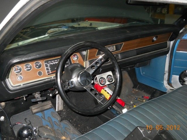

I'm in the process of changing my interior to black. The vinyl paint worked great on the dash pad, I haven't used it on the seats yet.
Of course prep is they key, I used Duplicolor vinyl paint.
Here is a pic of my dash pad, it's a little dusty but you get the idea.

I see your doors are blue. Was the dash pad that same color? Also your dash looks great. Did you redo that also..any tips? Thanks

Yup, dash pad was the same as the door panel. When I did the dash I pulled everything, sanded the dash itself and painted it. Painted the dash pad and put it back on. The cluster and bezels are some different ones I got on here.
Here's what it looked like before I started.
