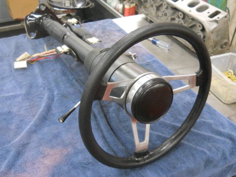

Or you can be like me and go completely crazy with it. Flaming river billet aluminum waterfall wheel adapter, modified by yours truly to mount a Tuff wheel.
just did one and a console . Made a big difference in appearrance.. You will need the wheel . The adapter can with the proper tapered nuts. The horn button adapter and the horn button
1970-1976 Dodge Charger Parts | MW799 | 1970-76 Mopar A & B-Body Tuff Wheel/ Rim Blow Hub Adapter | Classic Industries
Use your factory horn contact switch that’s on your existing wheel on the Grant wheel and pull the metal adapter piece off the horn pad of the grant wheel. It has the same expansion spring clip as your existing horn pad will fit onto the factory horn switch.
