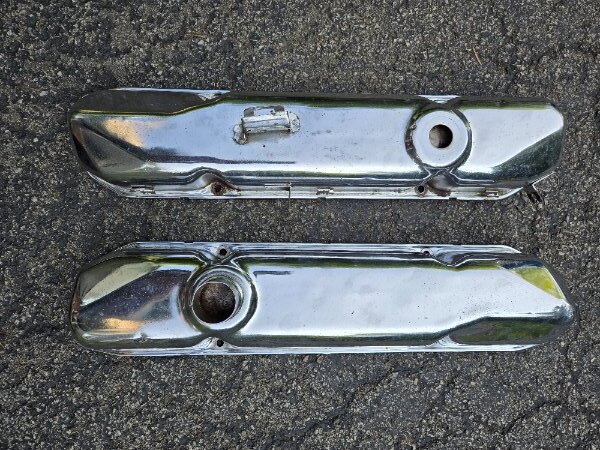

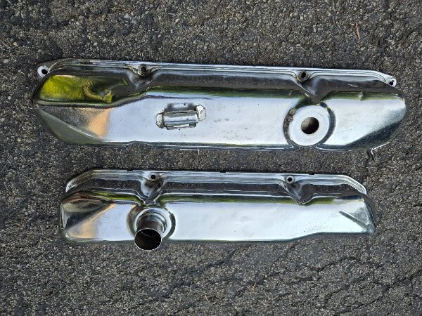

2 sets.
One from each set in each picture.
At least that's how I bought them 100 years ago.
I think I know what they came off, but what say the experts?

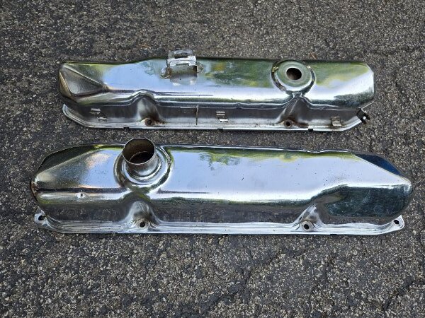

Very close to my 1968 BB. Unclear from your photos are the wire loom tabs and spark plug wire tabs. They look very nice, cost me $600 to re-chrome mine.
Those have heater hose brackets on them. Some 383 A bodies don't have them on the cover they are on the fenderwell.
Then the pass side has spark plug brackets in a different place. See end of cover on right = rear of engine
First set, both have plug wire brackets on top/back and inner/side, with heater hose bracket on one.
Second set, one has plug wire brackets on the back/side and the middle/side, and has the heater hose bracket.
The other has no plug wire brackets, no brackets at all.
You know, those look a lot like big block Mopar valve covers.

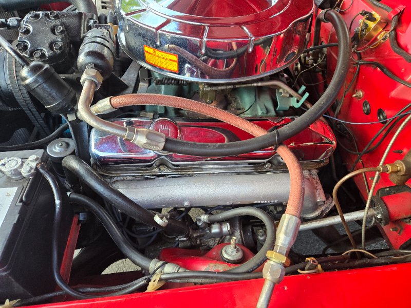

Took pics of a 64 Street Wedge.
Original owner car.
Both valve covers have nothing on them, no plug wire brackets, no electrical brackets, no heater hose brackets.
So the second set I have has the same driver side valve cover.

Strange that the rear plug wire bracket is on the top on the driver side, and on the side on the passenger side.
Driver side from my first set, Post #8.
Passenger side from my second set, Post #9.
That passenger side of mine has broken off wire looms and some rust, the other passenger side valve cover I have is in excellent shape, of course.
Maybe the 67 valve covers were different, typical 67 stuff being slightly different.
I found an original owner unrestored 67 GTX on YouTube with the set in Post #8.

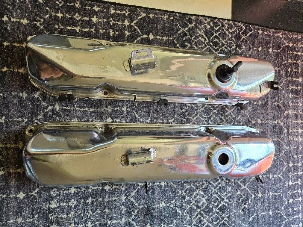

Looks like I was able to get this answered 16 years ago, doh!
Unable to locate this thread until this moment, but this reply makes sense.
Looks like I have:
A-body set (with the engine wire looms busted off the passenger valve cover).
Passenger side GTX valve cover.
Driver side street wedge cover.
People, stop bending the wire looms open and closed a thousand times until they all break off. Rant over.
Might just keep them all, not sure what the best path is to sort out a good passenger cover.
Thank you all for the input.
BB valve covers
The driver's side B-body HP manifold exits aft of the #7 exhaust port. On A and C-bodies, it exits between #5 & #7, thus requiring the #7 plug wire to be routed from the back, and requiring that one retainer on the top aft of the valve cover on those vehicles, but not on B-bodies.
