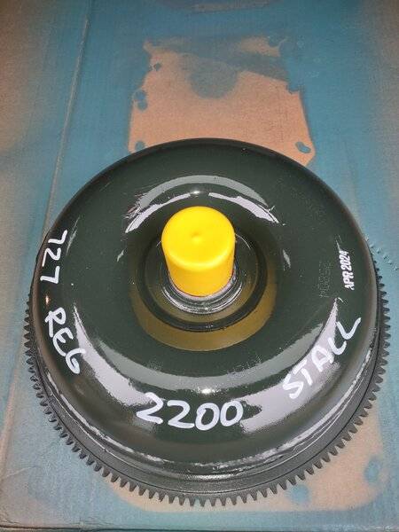

I used J&K Torque converters just outside of New Hamburg. If you have a core they will rebuild it to your specs. No shipping and no currency exchange.
I am installing the new engine and transmission over the winter. I haven't used it yet, but have good reports from others that have used them.

Like a lot of us, there comes a time to hit the retire button. I met Pat a number of years back at one of the big car shows in Toronto. We were at the show displaying our performance converters and in particular the drums, shafts, pumps and other HP hard parts we were producing. He also showed interest in converter parts we had started to make. Pat liked the products and became a good customer of ours. From a personal side, he was one of my favourite customers. Great guy and I hope he is enjoying retirement.
