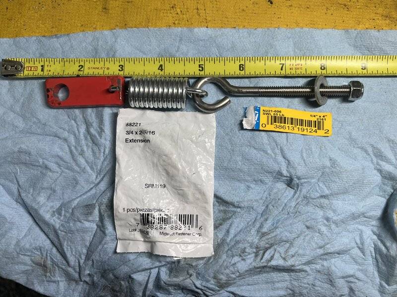

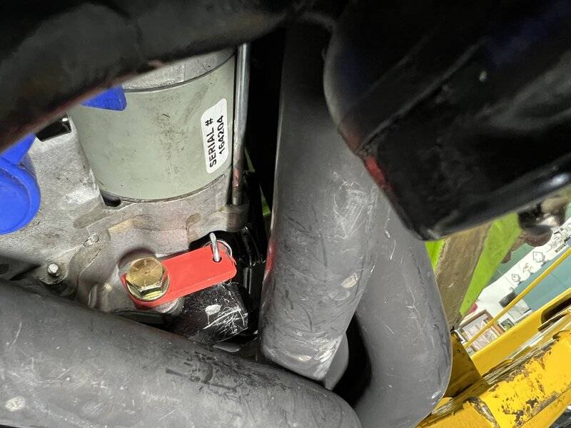

For what it’s worth, I fixed my clutch pedal not returning to normal position by building my own return spring solution. I made a small bracket from 1/4”x1” bar and (1/2” longer bolt) bolted it to the bottom of the starter. Then with a Menards special spring and eye bolt, connected to the throw out arm and adjusted the tension just so the pellet returns and the throw out bearing is off the pressure plate fingers. I’m happy with it.
