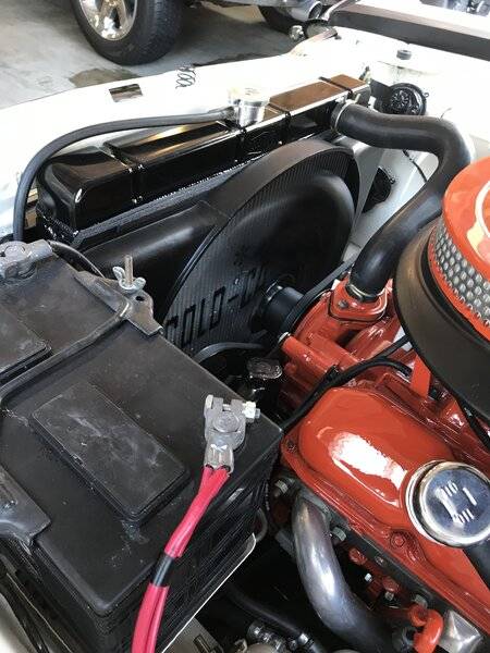

I ended up getting hardware store door weather stripping. Has the peel and stick side. 1/2" thick by 1" wide and comes in a roll like 15' . I just doubled up and stuck em to each other. Glued that to shroud. Mounting bolts will pull the shroud tight against the weather stripping to the radiator. Worked good for me..
Thank you, looks great
