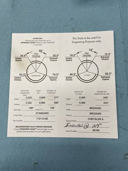

I’m amazed at how little lash that cam calls for. For comparison, my 422 is a very similar combo. Iron block, iron heads, iron rockers, and a Howards .600” lift solid roller. Howards wants hot lash at .022” and I cold lash it at .017-018”. I called Jones before purchasing a cam but I thought the grind he recommended was low on lift, at around .585” if I recall correctly.

Very close to my cam and same lash recommendations
