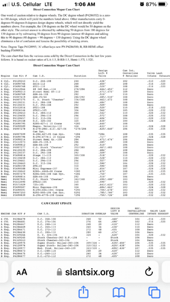

Direct connection.471 intake .474 exhaust 284 duration both 90 deg overlap.
The classic Street Hemi grind was 284 duration and .484 lift? The updated version was about 280 duration. Would you like me to look up the numbers?
No, thats the later hemi grind that replaced the street hemi grind. They are different.

The street hemi grind I’m guess is 85% of the advertised 284 duration which is 241 but I believe it maybe a little less. It doesn’t have a ridiculous high choppy idle. It has 109 lobe separation.

What are the specs for a street hemi cam for the 340?

No to my knowledge. You would have to find one used or new old stock. You could try Engle cams, that guy has ground alot of mopar cams. More than likely he would know what a street hemi grind cam is. He was also grinding fast ramps before most folks. He at one time was grinding Hughes engines cams for him. I also hear alot of good things about Oregon cam grinders.

I was thinking of the Direct Connection .471 intake .474 exhaust 284 duration cam versus the newer equivalent/better cam with the 280 duration .474 lift cam.
I’m not sure its a “better” cam, its just different and I have never run that cam. It may be ground for later cars like 72 1/2-73 and up cars with less compression and smaller valves.
