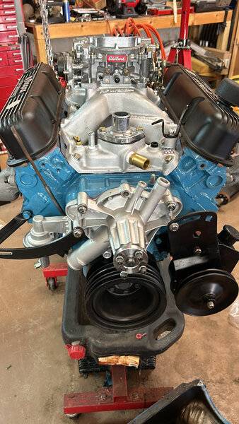

Sounds like he will have to source the non-ac pulleys and alternator bracket to use that compressor mount. Maybe not- it has a two groove pulley on the compressor, so may be able to get things lined up anyway.
OP- what year brackets and pulleys do you have? They changed over the years; ie single belt or double belt compressor drive, location of the PS pump due to original inclusion of or lack of an air pump, etc.

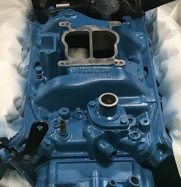

I can tell a huge difference in the amount of effort between the RV2 and C171. It was free horsepower anytime the AC is on which is most of the time in my car. As for the mounting, using the factory C171 brackets, mine clears everything on the Edelbrock intake on my car. In fact, it even puts the compressor in the same little cut out on the breather base that the RV2 sat in.
which edelbrock intake do you have and where is the thermostat relative to the intake? Is it centered or offset?

1971, 2 grooves on alternator and everything else is pictured in my original post
