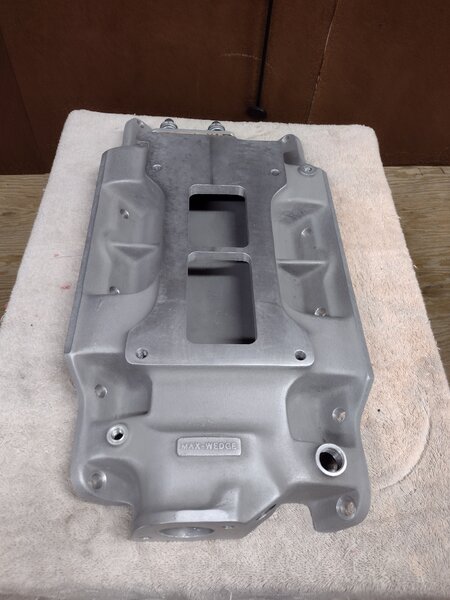

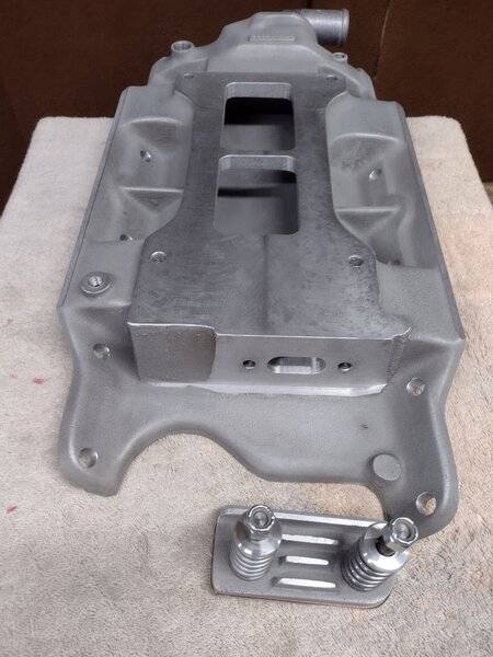

UPDATE. Received my new supercharger manifold today 8/06/25. She's a beauty!!!!
That’s sexy!! Lol
Is the blowers location in the same spot as your current manifold?
So the snout lines up with your crank pulley.
That’s sexy!! Lol
It will sit the blower back about an eighth of an inch compared to the Offenhauser based old manifold. When I have an engine on the stand I will mock it all up.
