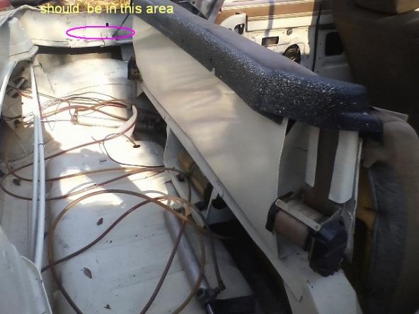

Here are a couple of pictures I found of the pump location for the early A.

Pull the cardboard panel between the trunk and the seat back, and the pump is in the middle of the hump. If it's original, it came with transmission fluid.
My '64 had that problem and it was leaky pistons and it wouldn't operate even with the pump filled. You can probably raise it by having one person lift the top out of the well to help the pistons, while the other person operates the switch

if it's an early A then it's behind the rear seat underneath the top well cover
you can see all the hoses routed to the center of the back seat.
That where the motor/pump us
it's hidden here so you'll have to remove the rear seat to get to it or you might be able to remove just the cardboard(mines not stock so I can't help ya there)
here you can see the tray it will be on. near the end of the silver area going towards the trunk
pump is circled
you can add trans fluid to top it off and see if it's work. plug is on the side and a PITA to fill. find a small hose that will fit in there to fill it. yeah your going to spill a bunch till you get the hang of it and even then you'll spill some:D

Thank you for all the advice... Thank you so much for the photos it really helped. We got it up....
