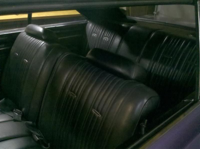

The Jag seats look like a good match to the rear seat as well, and belong in that interior. What do some of you do to get the rear seat and front seats to match? Custom fit the modern rear seats as well, get the old recovered to match, or just say screw it, good enough?
Then there's questions about seat belts...but I won't get into that right now.
This is my current interior.
Now about 10 years ago, someone was selling a pair of bucket seats on eBay in this same style. Wish I had the money then, but didn't.
My bench seat now is pretty uncomfortable. Vinyl sticks in warm weather, very springy and you bounce on the seats when going over any bumps. So I've been toying with the idea of going bucket seats when I redo the interior. But I do like the look of the seats I have now.
