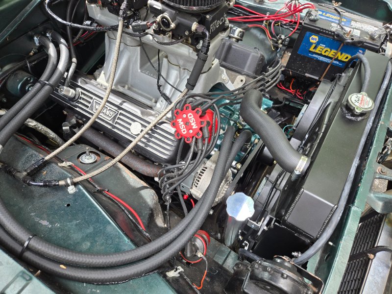

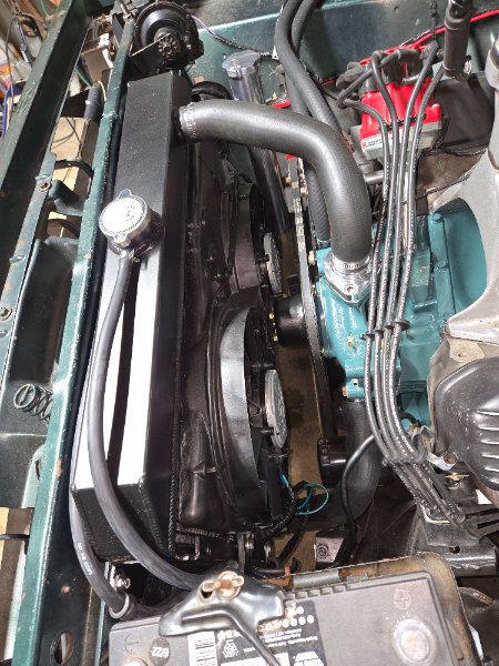

Swapped in a new radiator, electric fans, aluminum water pump housing, and new flowcooler water pump.
No other changes.

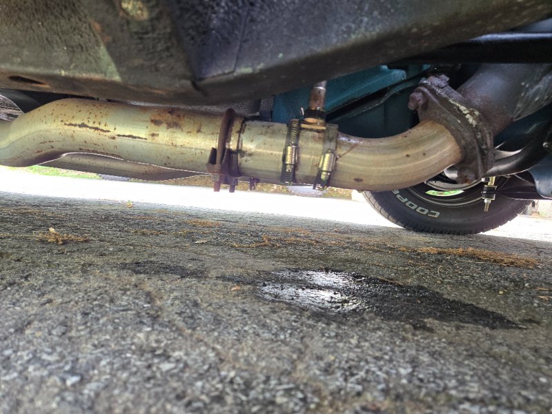

O2 sensor error, coolant coming out at the O2 in a constant drip.
Called 440 Source, their heads have closed exhaust bolt holes, do not go into water jacket.
Theory, flowcooler water pump blew exhaust gasket.

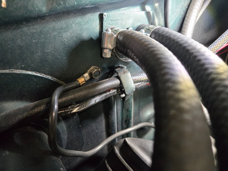

Are you SURE it's leaking out of the O2 sensor, and not just leaking on top of it from somewhere else? That's a lotta coolant that would need to fill the pipe to the point of coming out of a top- mounted sensor...
Run a compression test. Check the radiator while running, for bubbles etc. Check your heater hoses/connections (they're right above the sensor). And as mentioned, check your oil.

Leaking at the new heater hoses I just put on, running down the O2 sensor wire, not touching anything else on the way down, boiling on exhaust, appeared to be bubbling up from sensor.
Coolant not on anything else.

Then I called FiTech because I couldn't get the fans to enable. At that moment I recalled to 'toggle' you have to push the toggle button on the opposite side, not push the toggle button on top of the side you want to toggle.
Then the fans wouldn't kick on at all.
The brand new napa wire connector things that screw on to the maxi fuse and main power are complete garbage.
Some cluster duck of a nice heat shrink covering a two piece metal crap crimp area.
Swapped out for my 'old' ones, done.
Fans pull ridiculous amounts of air.
