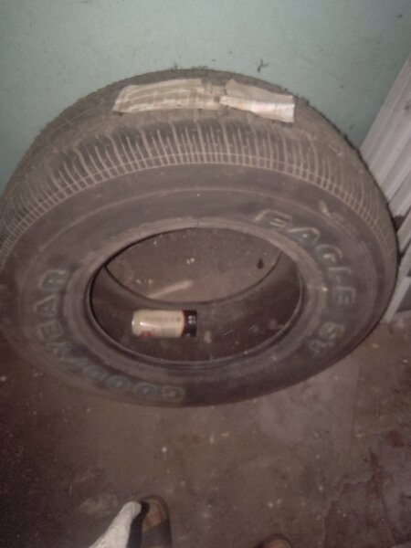

You know what I want? I want Goodyear to bring back the Eagle ST. Although they were pretty hard much like the BFG tires. I also want tire manufacturers to bring back the outlined white letters. They looked really tough on muscle cars and hot rods.
NOS 35yr old 245-60/14

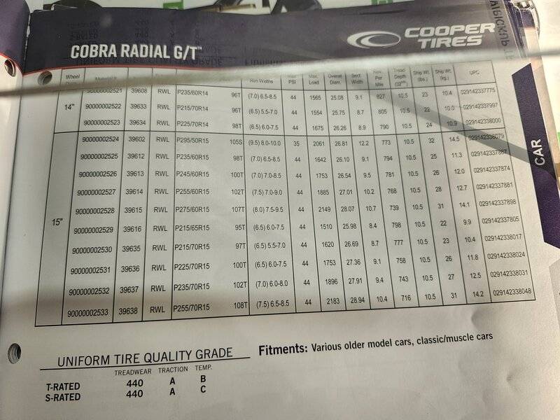

OK so was about to pull trigger on Cooper Cobras until tire shop said they don't make 205/60/15 which is what I have for BFG on front... :BangHead:

There are plenty of blackwalls and whitewalls to choose from. Even some red line and blue line. But I can find zero in a white letter tire that size, Steve.
The only thing I can think of is to go to a 215, OR drop to a 14" wheel.
At least I have all winter to finger this out....I still gotta drum up 15" steelies for the front .
have you checked speedway? i thought i saw some on there the other day when i was uh... doing research... (looking at 9" rears)
i ran into the same problem as you're having in that i just was tire shopping last week. smallest 15" cooper makes for the cobra is the 215 and it's way too tall to tuck in on the early cars with stock rim/backspace. i've got aftermarket rims with crap back space, so was even more jammed up and pivoted in an entirely different direction.
