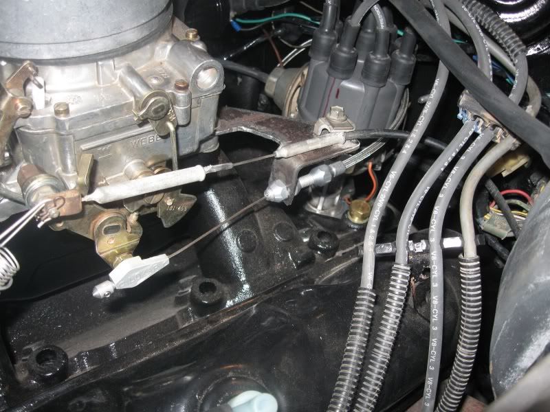

My 1974 Duster 360 was missing ALOT when I started going through the engine stuff....kickdown linkages, console shifter linkages,..ect.
I scored a Crosswinds Air Gap for cheap, and a Edelbrock 1406 fell into my lap for literally $15.00....I needed a bracket to hold both the Throttle Cable and a Lokar Kickdown Cable.......I ended up making what I needed:
So far so good.
