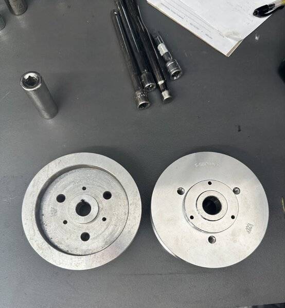

Another for you guys this morning. I have an email into CVF but being the weekend and I’m impatient I figured I’d ask…. Is this (pulley in right of pic) the incorrect power steering pulley? I have an existing CVF Saginaw PS pump with 5/8” key way shaft. I removed the pulley that was on it from my 360LA (left pulley in pic) but the new pulley has no keyway provisions. Is there a bushing or something I’m supposed to have?
Some were keyed and some were pressed on. Make sure your keyed pump and brackets mount and align before getting another pulley. It can be a puzzle mixing/matching.
Good luck
Pumps up to I think 73-74 use the keyway and then they switched to a press on pulley. Basically the pulley needs to match the pump. I also want to think the press on pumps are metric but that might of happened in the 80's.
You stated you have a "CVF Saginaw pump and pulley"?? I'm confused(easily lol), so both from CVF?? If so they should.match I would think?
Exactly. I told them I already had this exact pump and sent pics. I’m assuming it’s just the incorrect pulley but wanted to double check
Sending u the wrong pulley even after pics? Did you tell them its a Saginaw pump?(its not a CVF pump).
Make sure you have correct brackets for that pump before playing the pulley game again.
The pump bolted right up no issues. Think I was just sent the wrong pulley.
