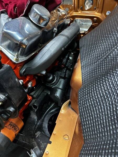

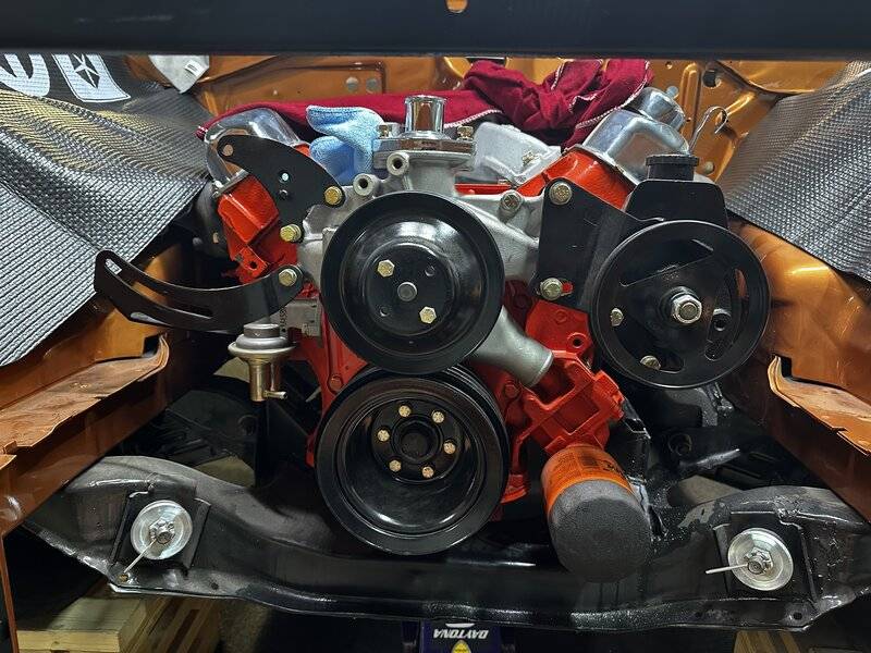

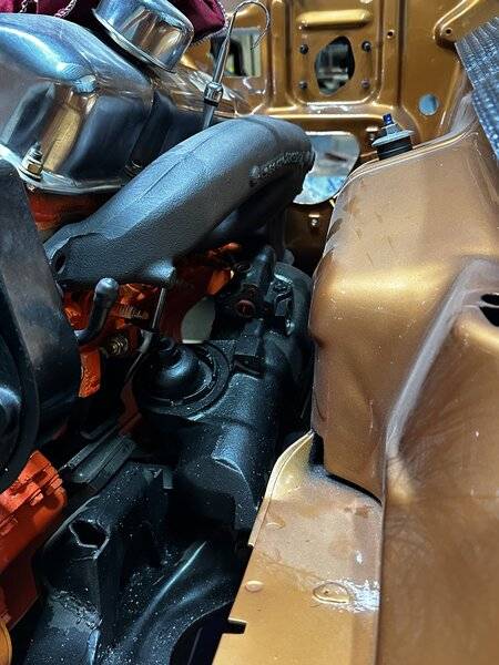

Pictures of current brackets, PS reservoir, and PS pump. I am not sure but I think these are all stock parts.
