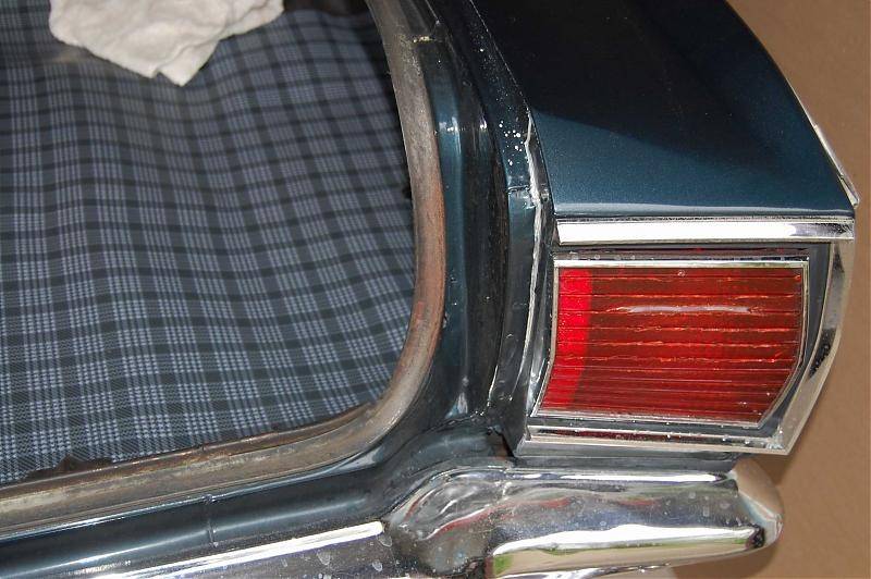

I need a picture of were in the channel the weather stripping sits. Also if anyone has a good picture of an uninstalled weatherstripping I could use that also. Not sure if I have the correct one.
Just removed one from a duster; it sits right against the inner lip; I 'm confused about sites want to know which style. Doesn't the year tell them?
OK, Here goes, (I did not know what car you had so heres mine, I think they are both the same see parts bag last photo....
1: 64 Dart trunk strip
2: 67 Dart trunk strip
3: 67 Dart trunk strip seam
4: Parts bag & seal
Hope this is what you're looking for, Good Luck!

Perfect, thanks. My car is a 71. I think I may have the wrong gasket though.
Here is a pic of another brand of seal same style. I trimmed a sliver off the end and laid it to the left of the UPC code (Black Shape is cross section of sliver I trimmed) Good Luck!
Heres the profile drawing from a previous pic rotated and added to.
Hope this helps in proper placing.
