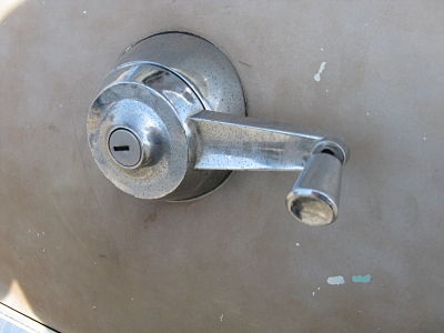

So, I've never had a key for the manual window lock on the tailgate of the 'ol wagon. The other day, I removed it, which involves pulling nearly EVERYTHING out of the gate, glass, regulator yada-yada. Took it to the local locksmith, he makes me up 3 keys. Re-assemble the handle, lock no workee. Screw with it a bit, still no, something is missing or broken in the mechanism. So, I guess i'm on the hunt for a handle. :banghead: Oh well, the regulator and handle all got cleaned and lubed, the glass sure winds up and down nice.

Yup, the key the locksmith made is an ignition/door style key, different however, from my doors, and my ignition. I suspect the ignition switch has been changed, and I know the entire tailgate has been. With the key made, the lock turns, I can't take a decent pic of the guts of the mechanism, but it appears that the lock cylinder should have a pin or cam of some sort to actuate the square pin that pops up into the adapter to the regulator splines, but there's nothing there.
If you can reach into the inside of the tailgate, run a magnet around the bottom, maybe your missing piece fell down inside?
