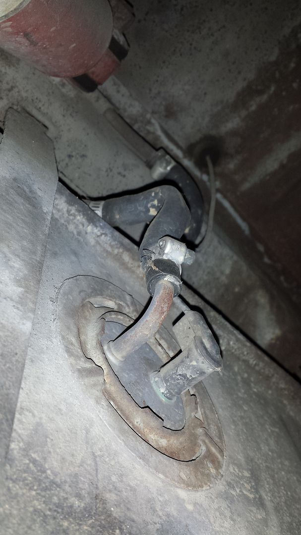

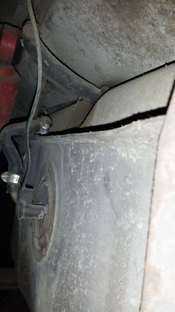

Well I found my smoking gun. I pulled off the fuel filter and blew into the line and nothing was moving through it at all. I jacked up the car and got underneath the tank to check the lines and see how to remove it...
Looks like I have a case of "There's your problem!" A kinked hose, really? The whole time? I pulled off the hose and gas started coming out of the tank freely and smoothly since the rear of the car was up in the air. I cut off excess hose, clamped it back up, turned it over, watched the filter fill up and it started up! I ran it till it warmed up with no issues other than the carb needing adjustment and timing. What a relief! :cheers:
Thanks for all the help and advice people! Special thanks to TrailBeast and nm9stheham, your tips are what led me to finding the problem.
