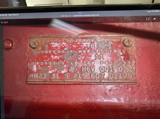

I need some help with decoding my Fender tag. The real question I have is the A 2 and the TRM H6V if you look up 1967 fender tag the TRM does not show up under 1967 Barracuda but if you look it up under 1968 it comes up TRM for a Signet. Iwill enclose a pic. Thanks for the help
The H6V is a Bucket Seat in White with Red
The 2 under the AX is the axle ratio nothing under the X makes it an open rear.
Alan
Thanks Al, I was hoping I could find out what the ratio is I just got the car the first of March and trying to get as much info as possible.
