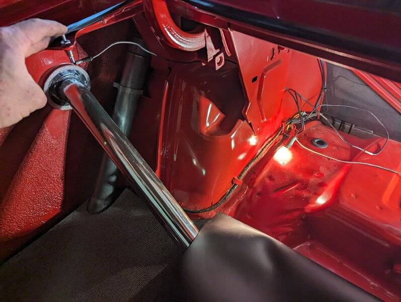

I've searched and only found info for Dart, Barracuda, and folding rear seat Duster mounting locations for the trunk light. I'm relocating the A01 light package on my tribute car. The harness and switch are straightforward, but I can't see an obvious mounting location for the light itself.

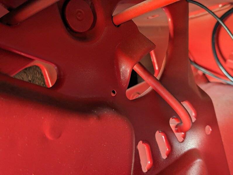

While I was under there I could clearly see the partial vin stamping in the package tray near the driver speaker cutout, I thought it was only the radiator core support and trunk drip tray.
Thanks to both, looks like a 1/4" screw does the trick. I had a long one for the armrests so I'll track down a shorter one. Also here's my vin stamp on the package tray
