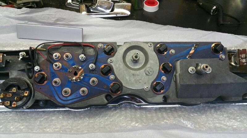

Your reply should be, "theres no issues with the bulkhead connector yet". If you dont want there to be, I suggest just as 67dart273 suggested to do the bypass, and convert the ammeter to volts. Plenty of articles on fabo to do that mod. Heres the bypass made simple top pic is what you got, second pic is what you need to do. Pix 3,4,5 ,are my ammeter converted to volts with the sun volt gage i used in pic 6.

No problem. When you do the volt gage conversion, just ground the negative stud on the gage to the cluster housing. The positive stud, you ream the hole in the gage bucket a bit bigger, then fit a plastic grommet in its hole and plastic washers as insulators on both sides, then run a jumper wire from the positive stud on the volt gage, to your 12V input going into the cluster. Heres a pic of the back of mine. I since removed the black ground wire since I grounded the negative stud to the gage cluster housing.
