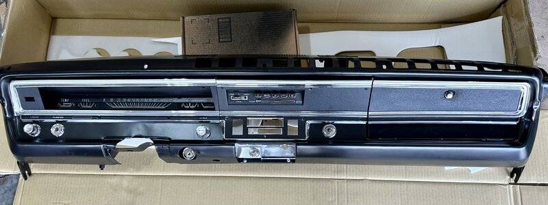

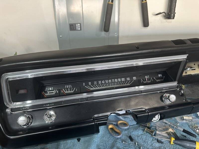

Does anyone know of any "How To" articles on how to get these dash bezels letters painted white? It's a tight spot to work in. I haven't been able to get it right with a small brush; I even tried the edge of a narrow felt strip. I cant seem to get the letters painted without touching the black background and/or filling the cavities of the lettering with white paint
Paint pen. Or use Wife / GF finger nail polish. Be careful.
From the factory they painted the lettering first, then when dry a stamp that fit the letters perfectly dropped over the letters and the back ground was sprayed. I saw a video on it on YouTube years ago. It is definitely a process.
I used a white paint pen when I did mine. I did everything that wasn’t already done with the brand new bezels. I practiced on an old set of bezels first.
