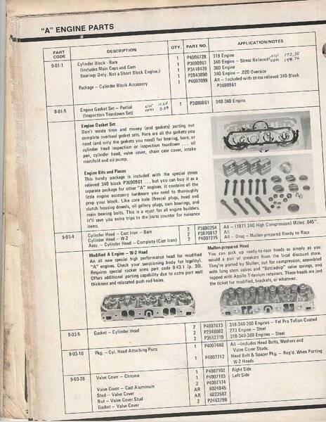

Was that dealership once named Massey-Brooks ? If so that is where my 70 Charger was purchased new . Still have copies of the window sticker , order and bill of sale.TA blocks were the original HD/race blocks before X-blocks came out late in the '70's(?), around or after W-2 heads. However, Direct Connection did sell blocks through their program which may have been production blocks. But the only difference from the factory OEM blocks appears to be "stress relieved". It's been almost 50 years but I bought one through Massey Chrysler Plymouth on Beach St. in Daytona Beach, FL. (Note the prices!) However, I don't recall it having any TA or X-block features. Based on the catalog wording/descriptions, I would think the 340s were a factory blocks along with the others. I suppose that the OP may have one of these. But I can't think of a way to prove it without documentation, features or part numbers on the block. Either way, it would be another OEM part assigned a P-part number and sold by DC.
Same listing in 1977 but Nov. 1979 shows the "NEW" race block with 2 or 4 bolt mains and the rest of the blocks listed as "production".

1976 catalog:

The only reason I'm asking is because the original owner to my GTS dart that I just bought said that this block was a direct connection block he bought it in the seventies I have the original 340 block also but I really physically can't see any difference and I don't really know much about the direct connection blocks
