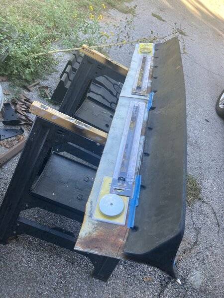

So, the idea I’m going with for now is magnetic application. I had several Horrible Fright magnets to employ. The base is a deck lid from a fellow FABO member.
I will be skinning the base and place the magnets in the skin. Coat the bottom side of the skin or apply double-sided tape, neoprene, silicone, etc.

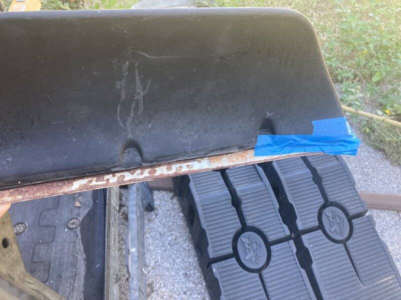

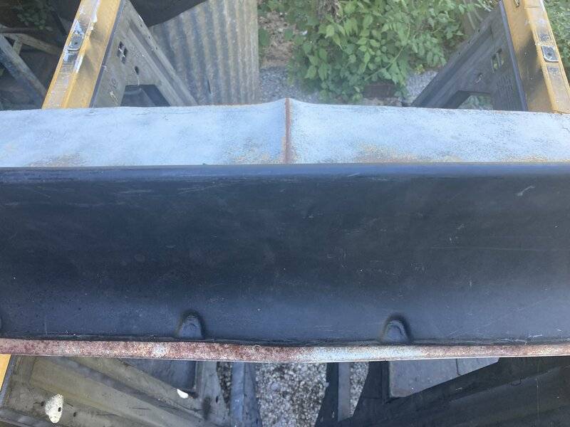

It’s all baby steps here. The spoiler is pretty bad. It’s warped and bowed. I’m thinking about attaching the corners and working the fiberglass. I have never messed with fiberglass before so this could take months.

The magnet strength isn't a concern for me. I am confident that with the arrangement I have pictured (2 round, 2 bars) would hold. The concern would be magnetizing the trunk. FOr this I would use a type of Ultra High Molecular weight hydrophobic sheet for the painted. This would reduce fastener to paint interference.

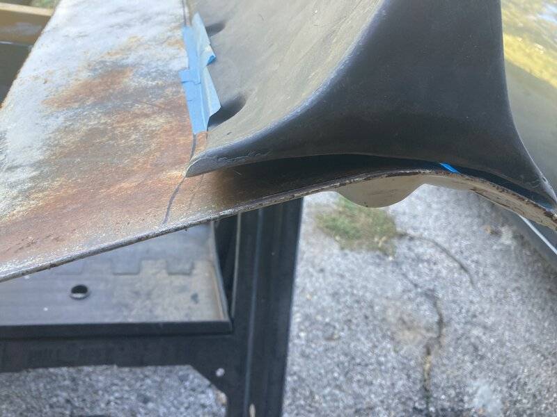

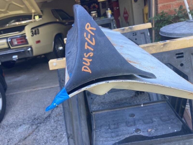

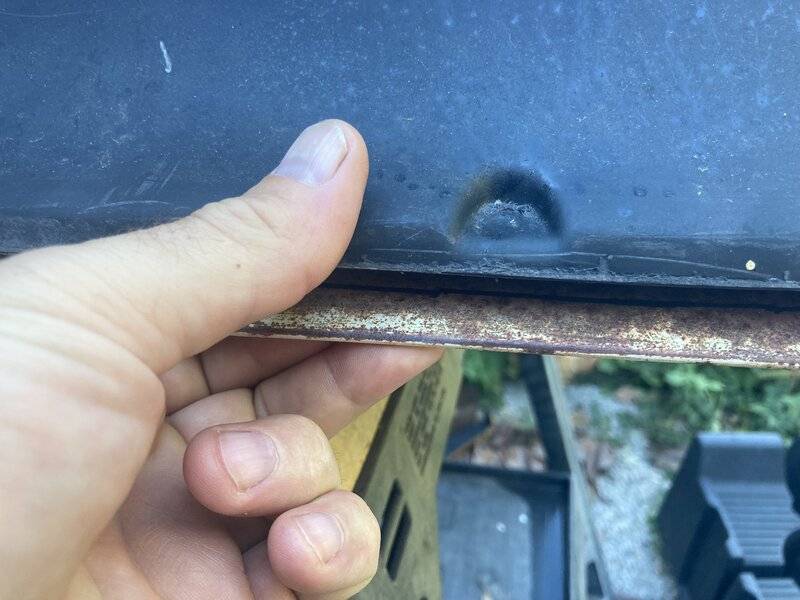

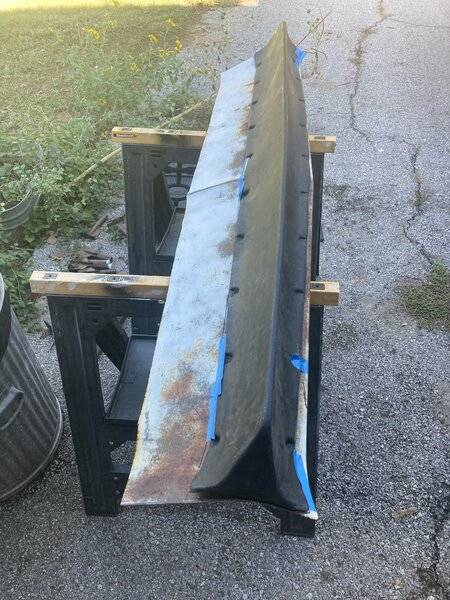

From a couple of those pics....is it upside down?
The gap looks like it would conform better the other way.
If you are imbedding magnets into the deck lid.....why not just bolt the spoiler on?
Not upside down. There is a slight curve in the edge of the trunk lid and the spoiler is shaped for that on the rear edge. The front edge is straight.
On the magnets, I would use the trunk skin you see in the pics to use as a metal base . That would then mount to my painted trunk with magnets imbedded in the spoiler base (donor trunk lid). The skin will, now spoiler base, would be perfectly contoured for a good double sided adhesive too.
