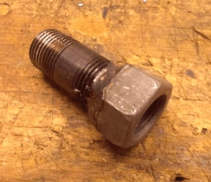

If a pilot bushing attachment on a slide hammer won't fit, make an adapter for the end of the slide hammer like this and thread it into the bushing. I made this one to remove a pilot bushing in my 727.

Interesting! I've never seen the purpose-built tool for removing those. Makes sense though. Hell, a bolt with grooves cut into it welded to a piece of all thread and a nut looks like it would get it done. The OP should be able to figure something out.
Yeah, I posted that so he could see how easy it would be to make one. 112 bucks my big old butt.
The right size all thread rod, grind it to a semi point on the end and take a whiz wheel and cut a groove on it so it'll cut. A big thick flat washer on the other end on top of the distributor hole and a nut. Done!

I dont need one , but "you da man ROB "
I`d make one tho after seeing the pic...
