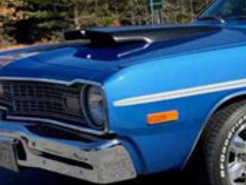

The 71/72 fenders are the same length as the 73-76 if you include the length of the fender extensions on the 71/72 fender. So overall, they’re the same basic dimensions with the extensions included. The hood is shorter on the 73+ cars but the header panel makes that up, the fender length isn’t different.
The biggest difference is the bumper relief and lower valance. The 73+ fenders don’t have a lower valance at all, they just used the really tall bumper. So if you wanted to use the 73+ Dart or Dart Sport fenders on a 71/72 Demon you’d have to reshape the bumper relief area and change the whole lower front section to accept the lower valance.

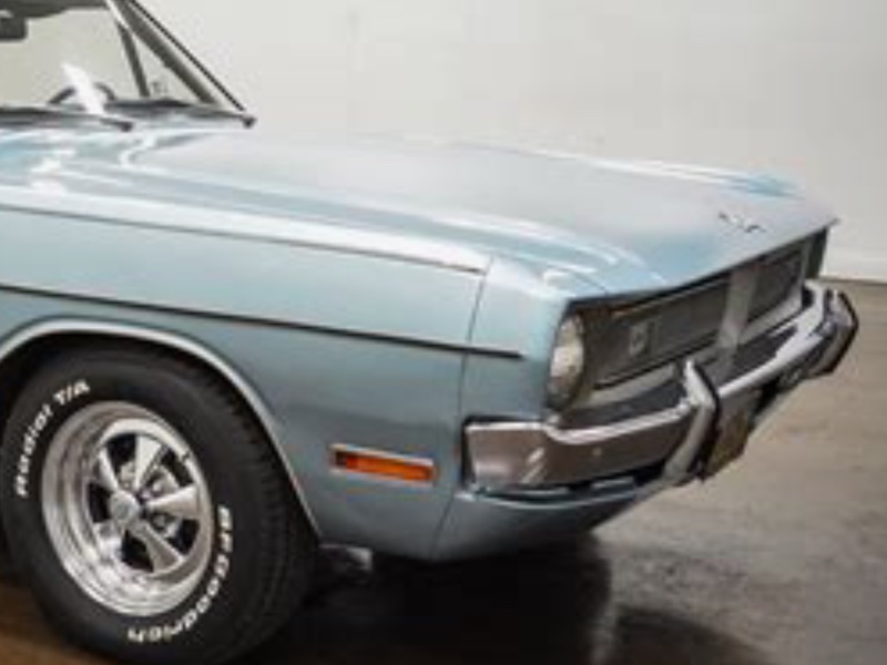

another big problem is a 71-72 demon dart has a fender extension and the 73-76 cars don't have one, it's all one piece. A body guy can make it work but it won't be right.

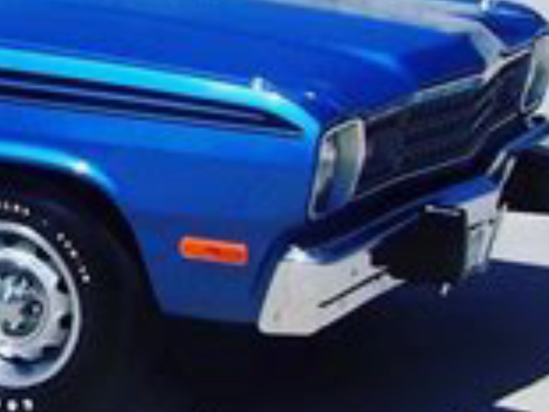

First picture is a Duster, whole different deal. Duster fenders are the same for the whole run except for the marker lights and a few brackets.
For the Dart fenders, if you insisted it look exactly like a 70-72 fender, sure, you’d have to fit the extension. But that wasn’t the question.
If you’re not worried about it being “correct” you just leave the upper part of the fender alone. 67-69 was one piece, 73-76 was one piece, the 70-72 fender with the extension attached are the same length as the other ones.
But yeah, you’d have to re-do the lower front section with a flange to accommodate the lower valance if you wanted the 70-72 bumper, and reshape that bumper relief.
It’d be easier to find the 70-72 fenders and extensions. But if you had the 73+ fenders and can run the tin snips, a hammer and a dolly you could rework those fenders cheaper if you didn’t care about the time.
