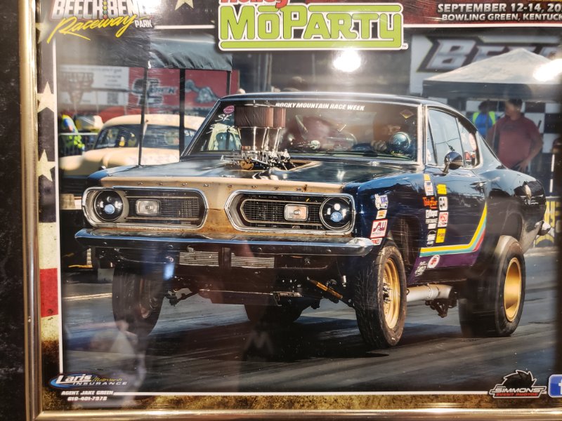

I have a Detroit locker in the S-60 in my Barracuda. If it does make noise, I can't hear it over my 3.5" side pipes!
In summary, install side pipes with no mufflers.
