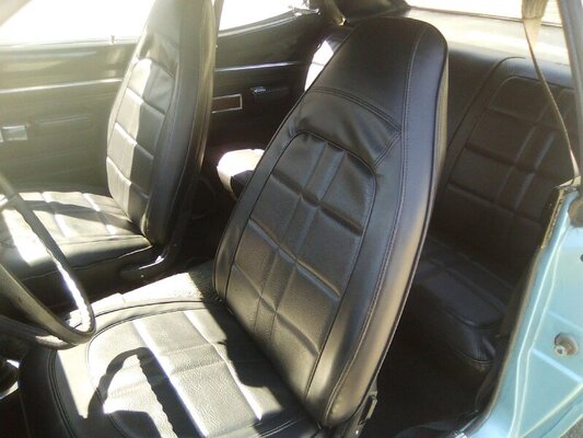

So right now in my 71 Demon I have the wrong rear seat. It is a bucket seat car "C55". I might have a lead on a seat frame for a Duster that should be correct but would need new covers. So I want to order legendary covers asap as I know they take 8 months to ship out.
The problem I am having is that Legendary only has a Black/Charcoal seat cover and the bucket seats currently in the car appear to be all black. I gave them a call and according to the guy I talked to all 71 Demon/Duster seats were Black/Charcoal with the code "M6X9" which is present on my fender tag. Is this correct? I attached a picture of the bucket seat which appears to be black and the fender tag for reference. So maybe someone reupholstered the bucket seats in all black at some point? Or are these not the correct seats? Based on several cars I've seen online they appear to be correct and I've seen a few 1971 Demon 340 bucket seat cars that appear to have Black/Black seats front and rear.
To sum up I am trying to make this car as original as possible so I was hoping someone could tell me if the seats should actually be black/charcoal. The guy at Legendary said they could custom order a rear seat cover in all black with a 25% customer up charge so I need to decide if I want to do that our just recover the front and back together.
My '71 340 with M6X9 are black and charcoal both front and rear. I believe they are original to the car.

Cool thanks, I'm guessing someone must have recovered the buckets at some point with covers from someone other than Legendary (they are in really good shape). So now I need to decide is it worth recovering both or the cheaper option of the custom black rear seat.
My understanding is the Demon 340 should have black/charcoal. My 71 Demon 340 has 1 of each front seats and the black/charcoal rear seat. It was a misbuild as originally built. I've had the car since 84 and got it from the original owner who had never changed seat covers. The 3rd original broadcast sheet was even still intact (rough shape) under the incorrect black/black front seat!
If it were me, I’d order the custom all black rear seat to save a bit a money but I do understand wanting to keep it as original as possible too.

Damn if I wouldn't go back to the Black/charcoal seats, they add a lot of class to that interior!

Interesting... If I was going to guess I'd say my bucket seats were recovered at some point since they are in way too good of shape but I guess I might never know for certain. I'll get in contact with the guy I bought it from and see if he can give me some more info about the interior If he knows anything, he wasn't the one who restored the car.
