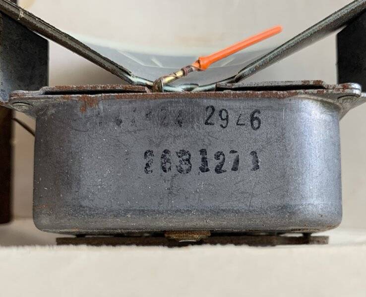

Does anyone recognize this fuel gauge?

I was able to ID it a while back when I first got it, but I forgot how I found the info. The only numbers I can read on it are stamped "2926" and "2631271" or "2831271." I've searched and searched and cannot find a match online. Any help is appreciated.
Yes, 1966-67 Charger
2926 is 292nd day of 1966

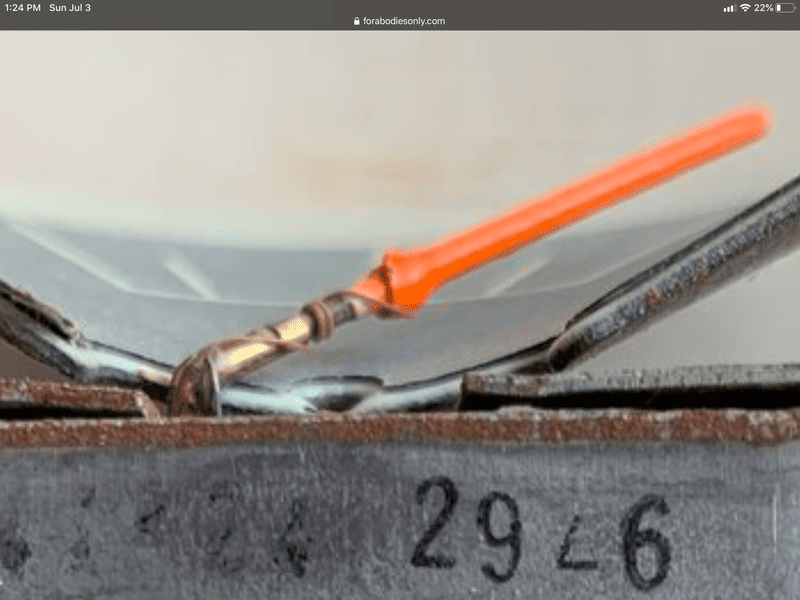

see that tiny wire wrapped around the needle? Those needles light up with the Electroluminescent dash lighting
