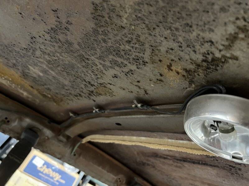

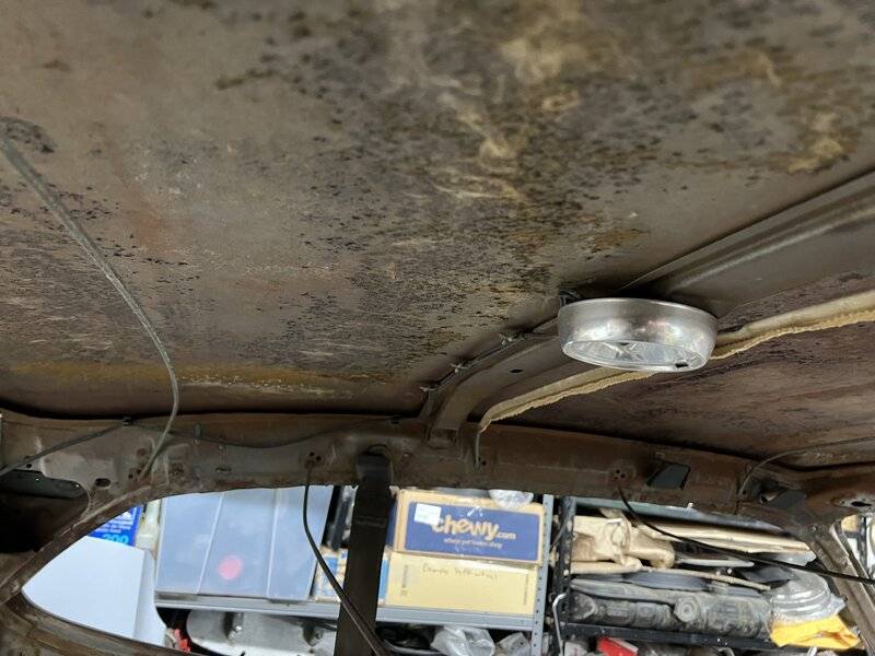

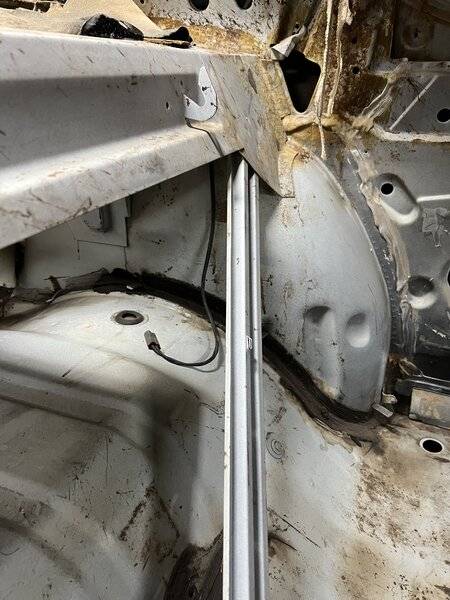

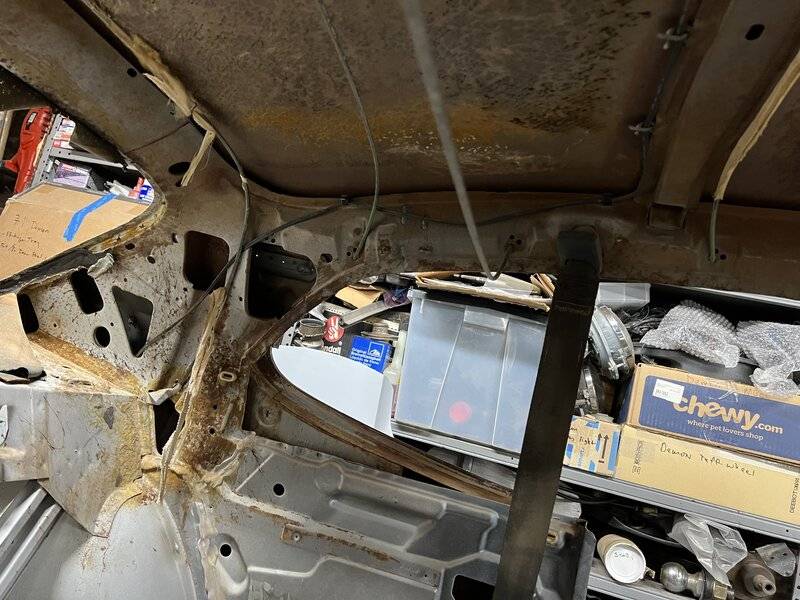

Fast340cuda Well-Known Member Joined Jul 25, 2013 Messages 339 Reaction score 264 Location San Jose, ca Jan 15, 2023 #3 Here is the dome light harness routing in my 71 demon. Guessing this would be similar to 72. Let me know if you need more!
