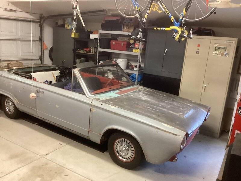

Looking at a 1975 valiant four-door with a six cylinder and a manual floor shift. My question is will the drivetrain fit in my 63, engine, transmission, and rear end. thanks in advance for any replies.

Yes, the car has a manual transmission already in it and I’m looking at the whole donor car. It is complete. Thanks
