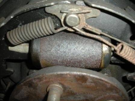

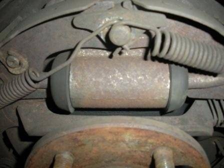

How do I know if these are the newer style wheel cylinders? 1 of them looks new & has a part # on it but the 3 attached below look older. Does anyone know if these are safe to use for the master swap or do they need to be replaced? Thanks.
