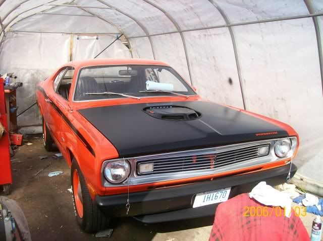

I did that grill set up probably 10 to 15 years ago , so I don't remember exactly where the holes were that I had to drill , I do remember it was easy to see once I started to put the grill in.... ( Here is a pic of both my Dusters a few years ago , they look the same now )
Frank
