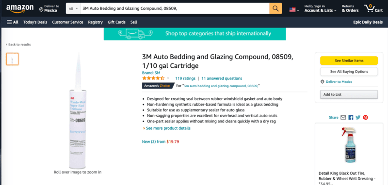

The instructions are a bit unclear in the manual. What current products would satisfy the products called for (weatherstrip cement and weather sealing compound) is anybodies guess.
