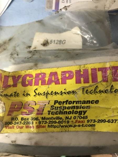

Call PST, they have them. They will want the diameter of your sway bar to get you the right ones.

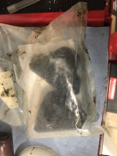

Dartsun doesnt understand. i have what you need but it will take some work on my side.
red
Thanks for the walkthrough dibnons, May need to go that route,
Thanks Red please let me know
