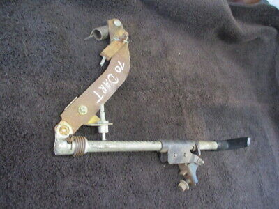

If you are referring to the bracket that is attached to the under side of the dash, the pin is held in place with one of those toothed washers that can only be pushed on one way.
Internet pic for illustration
This is a good example of a photo is worth a thousand words
@340Dart how about a photo of what you are talking about, or at least markup a photo from the internet.
I count 5 pins on the mechanism
Call out your pin by the color
