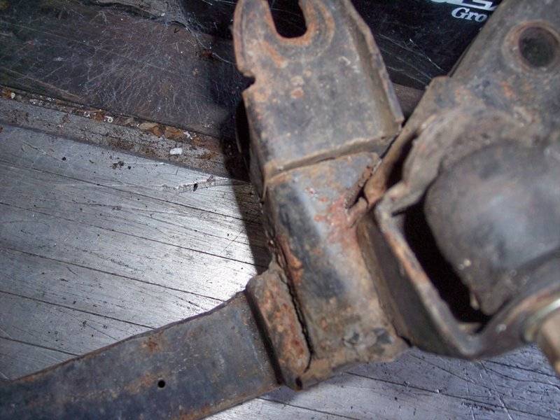

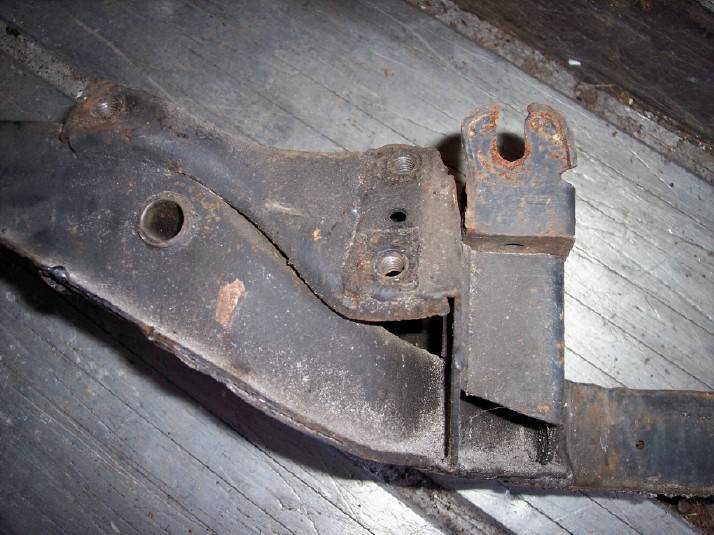

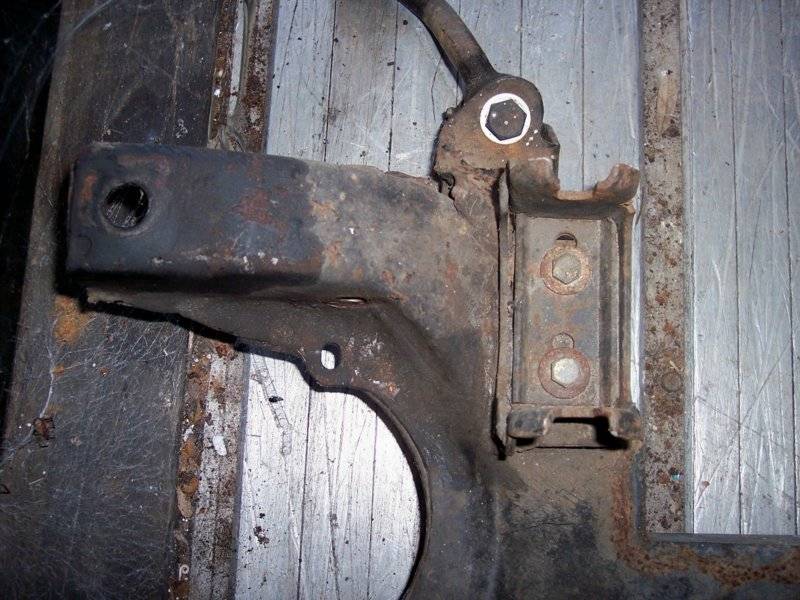

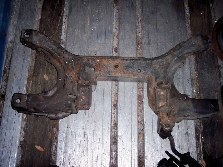

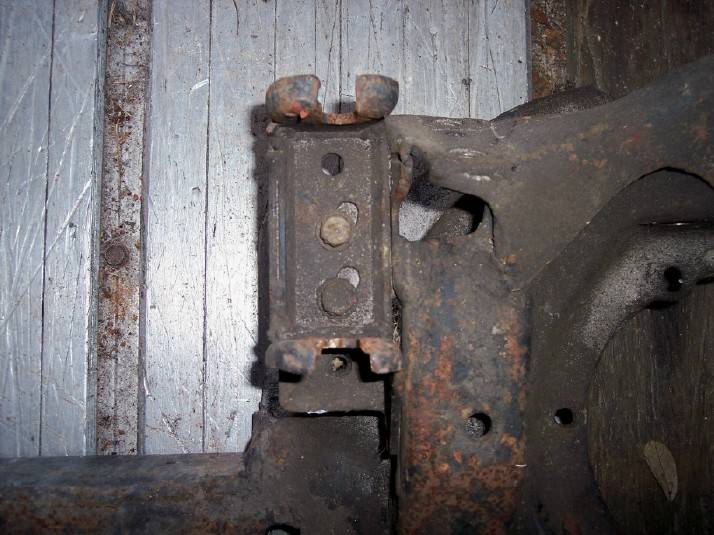

I have a spool mount K member that was modified like that by a friend of mine. One direction they fit a SB, unbolt them and turn them around and they fit a BB.
Here are some pictures of the custom BB/SB K-Member. The mounts unbolt, turn 180 and bolt back for the two different engines.
