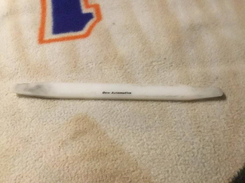

Left me one of his bone tools as well!

Okay these guys must be brothers. TC did the same thing and gave me some of his butyl rope caulk.
