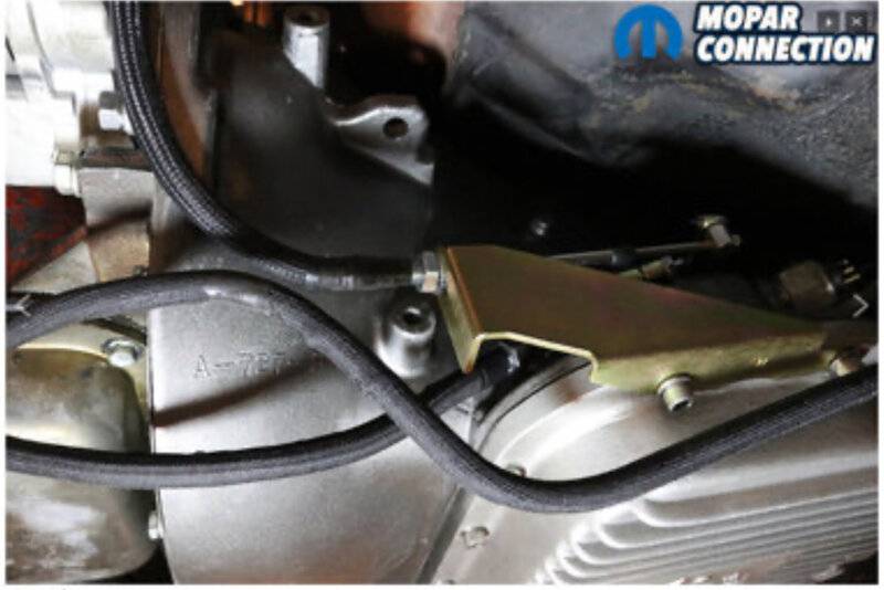

Generic shift cable pict from da web….. so where’s your issue?
Personally I found these brackets a huge pita…. Some headers like to try and share that space and messing with the shifter to drop the pan I was never a fan of..
Good time to lube the new morse cable while it is off.
If you have a steel pan, don't forget the washers in-between.
Guess I was hoping someone would say, "So-in-so makes a more flexible cable." or something to that effect. But as someone replied, "You spend all this money, you expect things to work like they say....." Just don't have faith in something you had to jerry rigged together. Plus it looks like ***. Friend suggested using bicycle cables! Told him to get off my driveway. haha.
Gonna give bending the bracket out a bit and see how that works.
