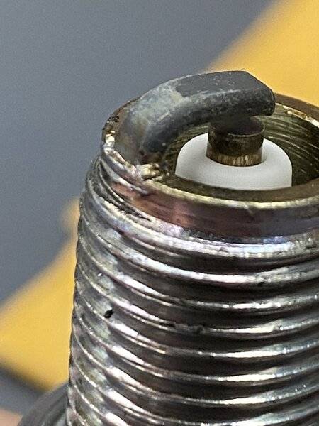

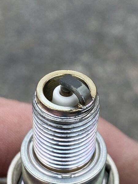

Anyway, I’ve got my idle mixture setting spot on, nice caramel color and now have moved on to 1/2 throttle “jet needle” and “needle jet” midrange tuning. Did a 1/2 throttle run (approx
4500 rpm) for about 5 minutes with a new NGK BR8ES plug and this is what I’m getting. Looks lean, probably need more fuel? but my question relates to timing and possible heat range of the plug:

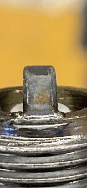

Looking at the strap you can see the two distinct discolorations. Not sure about heat range. I’d think I need to get the jetting dialed in first for that?
But regarding the strap indicating timing, what do you think? Any input greatly appreciated
