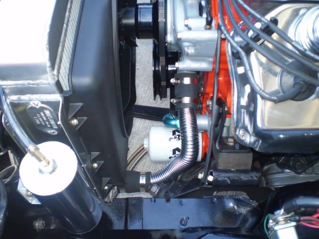

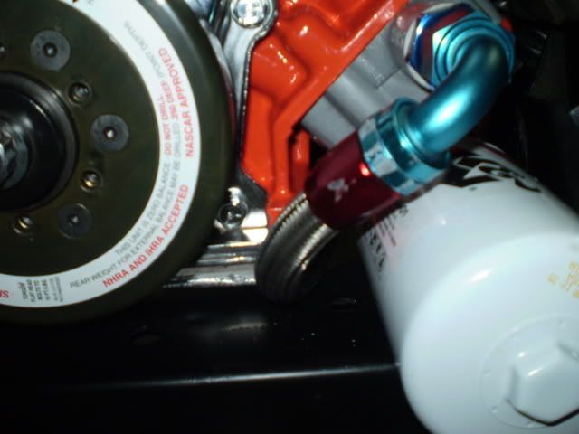

Sep 8, 2009 #3 68 HEMI GTS Well-Known Member Joined Oct 15, 2008 Messages 1,012 Reaction score 1,005 Location in the garage i run my hemi on wedge mounts, didn't want the look of an engine plate. i do run an external single line set up, i just use the milodon pump ( with the front suction ) & the cover off my internal HV pump.
