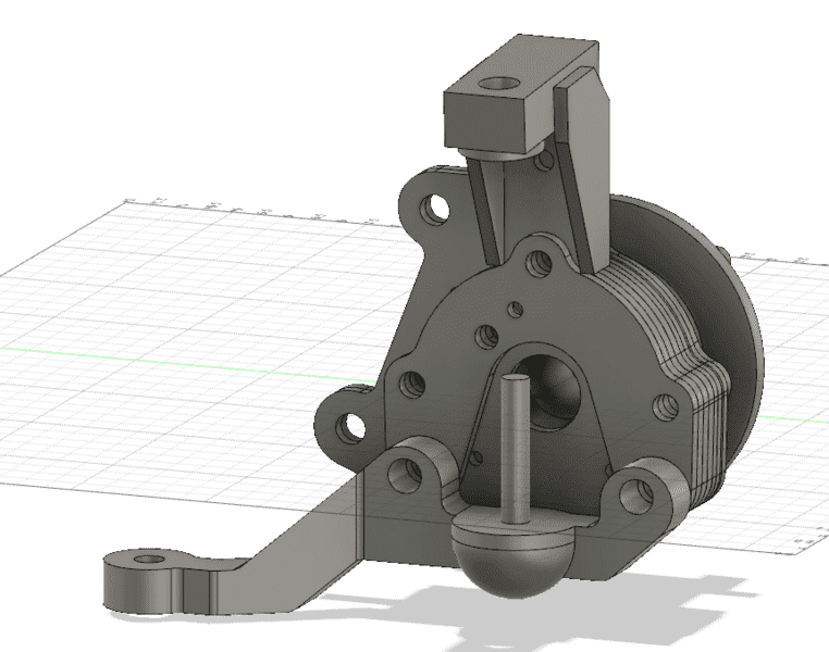

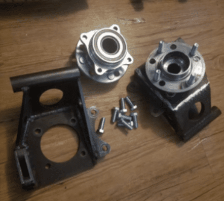

I am looking at my 4th revision on my custom spindle. I just duplicated the F-Body geometry though and haven't looked at making it taller because at the time it didn't seem like anyone was worried about the stock spindle height. I started with a bolt on setup for a stock disk brake spindle to use the 4 piston Brembo's and 14.2" rotors from a Challenger so I based the custom updright around that setup. I originally tried to use the Challenger front hubs but bought (and then returned) 2 or 3 replacement hubs to check the wheel bolt pattern and found they all used the 115mm bolt circle and wasn't going to go down that road. So I stole the S550 hub idea off the spindles RideTech introduced.
It's all just flat plates welded together and bolts, but I have been trying to come up with a better system to set the hub location. The distance from the hub to the caliper ears is pretty important and the plates have some tolerance on the thickness that can stack and upset things a little. But with flat plates and laser cutting from SendCutSend, I think it was only $500 for a pair but it's been awhile since I did up a quote. The biggest issue is the UBJ mount. I was planning a solid 1" thick bar and a washer to duplicate the stock spindle thickness there and it would require the taper to be reamed into it. More work to do there as well.
The real reason I started look at this was that I wanted to run ABS wheel speed sensors. So this setup has provisions to mount LX/LC sensors.
This most recent go round, I spent some time thinking about brake packages. I like the OEM stuff just because it seems like you can get parts for much cheaper than the aftermarket Baer or Wilwood stuff. Maybe it isn't as good, but hopefully good enough. I was going to jump up to the S550 6 piston 15" rotor package as my 18" wheel should still fit, but I decided I didn't want to put 34# rotors on the car. So I plan to stick to ~14" setups. The S197 4 piston setup seems like a nice package, but the S550 4 piston setup is junk. The only one I didn't look at was the Camaro 1LE stuff, but a Corvette hub, those brakes and a swap to a GM bolt pattern might not be a bad option.

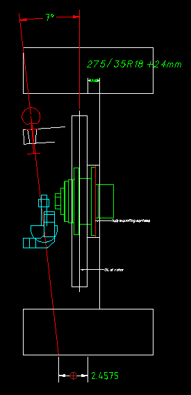

One of the things I looked at was scrub radius. The stock spindle appears to have about a 7 degree SAI and with my setup, I am getting about 2.45" of scrub radius. I think that could be better. Note that my custom upright results in the surface the wheel bolts to being in some compared to the stock spindle by maybe 3/8" or so. Changing the UBJ location and SAI to reduce the scrub radius would require shorter UCA's or the aftermarket adjustable ones. So that's up in the air, too.
Another discovery is that the LBJ isn't centered on the spindle and there is about 0.5 degrees of negative caster built into the stock setup.
I've thought about moving the UBJ hole back about 1" as that would create about 6 degrees of built in positive caster and would keep the wheel more centered in the wheel opening. But I haven't figured out if I will try it, partly because I think I would have to move the caliper to the front of the upright and I'm not sure that won't create issues with the sway bar. I think it would be a better location in the end, just not sure it wouldn't snowball into a custom swaybar like Joe just built.
I am going to try quoting from the original posts to continue the conversation. We will see how that works out.
So glad you shared your design. I remembered seeing it but couldn’t find it anywhere. That’s what prompted me to go down the “what if” path on a spindle. I want to add ABS, a hub spindle, and better brake options. I recently found Michigan Metalworks who builds beefy spindles for full size trucks and that got me going further.
I was tooling today and found a dual bolt pattern C7 hub, and that paired with a set of readily available GM calipers can be a great option, just need to firm up a rotor.
my thought is to grab a C5 spindle and hub off eBay, get the measurements for the caliper ears and hub mounting, combine that with FMJ pick up points and go. But if going to all that work, it makes sense to go all in and determine what the optimal points are at X ride height for the UBJ and LBJ. If, collectively as a group, we could do that, we could possibly come up with a great solution, or at least know what it would take to get these really dialed in.

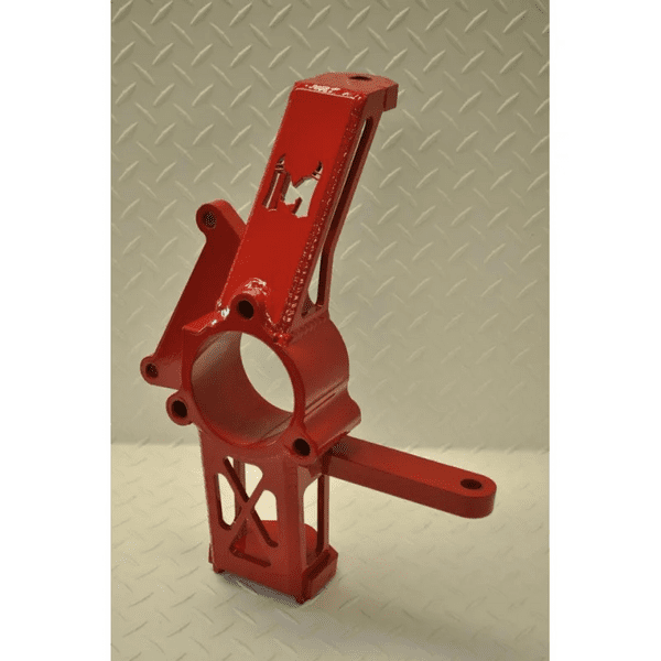

A link to Michigan Metalworks website and their fabricated spindle.
Custom Fabricated Spindles
Are those the CPP hubs? If so, just be aware they don't have the ABS tone ring in them even if they look to have the rubber cover. I talked to them at SEMA last year and I guess the extra steps and machining to get the dual pattern make it impossible to put the tone rings on. Or something like that.
Cool! Looks like they could certainly come up with something that would work.

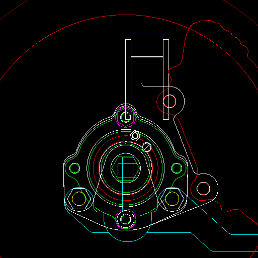

Have you thought about designing your knuckle to be 2" taller than stock from the centerline of the hub/spindle...
With an 18" wheel with any decent offset and width, I don't believe a 2" taller knuckle would fit. @BergmanAutoCraft has said he is running 1" taller balljoints so that would work, but I would bet that is the limit.
Note that the "inside" of the wheel above is just a line at 9" from the centerline. The wheel is going to take a chunk out of that distance.

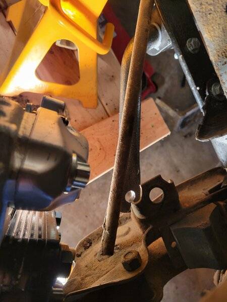

I went out last night and bolted up the Scat Pack brake adapter setup I have onto my '73 Hemi swap car. The car is on jack stands with the torsion bars loose and the spindles in their "natural' location (i.e. calipers to the front) unlike my '74 so it was a great opportunity to see if those massive Brembo calipers could be mounted to the front of the spindle. I prefer them in the back, but it doesn't work well with my idea for moving the upper balljoint to introduce some built in positive caster.
Looks like there are miles of room with the '73+ front suspension:
Might even be enough with the earlier sway bar, but just a guess.
Even with the suspension (mostly) compressed:
The only caveat to this is, the caliper is actually back a little on the fabricated spindle compared to this. My current design appears to be 3.4453" from the back of spindle to face of the hub while the stock spindle and cut down rotor is 3.875". So the caliper will move back about 7/16" compared to the above mock up.
Part of why I am thinking about swapping side for the caliper is so I can move the upper balljoint mount back an inch. It would look like this if I left the caliper as is.
This would build in about 6 degrees of positive caster. I might bump that to 7", it's all just speculation right now.
Here is how the stock spindle looks with 6 degrees of positive caster.
I haven't looked at the steering closely enough, could be tilting the spindle back makes it better. But it also moves the tire back, which helps with clearance at the front lower fender, but it hurts the clearance to the rear edge of the fender. Keeping the spindle more vertical and building in the caster would also keep the wheel centered in the opening.

I think I just did up the knuckle and let the hub land where it was. But I have already bought (4) 18x9 +35mm wheels so wasn't excited about a different offset. That said, I struggled to find 9" +35mm wheels that would work and a +30 or even +24 wheel seemed easy. So it might actually work better if it is a new build to keep the rotor back.
That said, all of my designs have been a flat plate welded assembly that could potentially be a bit modular so it could maybe be build both ways with just the addition or subtraction of a couple of plates.
I should add that I have been trying to keep this thing free from having to access a machine shop. I have been very happy with SendCutSend so far and my plan have been laser cutting all the plates and then plug and stitch welding the parts and depending on the bolts for the hub and LBJ to make it strong. The only caveat is the UBJ mount, that would take a real weld as it is designed right now.
The new stuff I have been toying with was started due to this spindle.

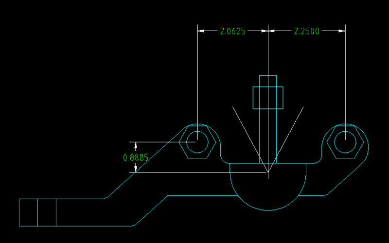

My first design had an issue with the bottom hub bolt interfering with the LBJ, but the later iterations fixed it without changing the hub centerline.
