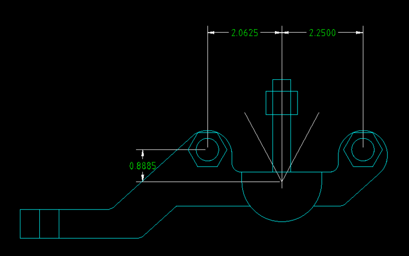

I am looking at my 4th revision on my custom spindle. I just duplicated the F-Body geometry though and haven't looked at making it taller because at the time it didn't seem like anyone was worried about the stock spindle height. I started with a bolt on setup for a stock disk brake spindle to use the 4 piston Brembo's and 14.2" rotors from a Challenger so I based the custom updright around that setup. I originally tried to use the Challenger front hubs but bought (and then returned) 2 or 3 replacement hubs to check the wheel bolt pattern and found they all used the 115mm bolt circle and wasn't going to go down that road. So I stole the S550 hub idea off the spindles RideTech introduced.
It's all just flat plates welded together and bolts, but I have been trying to come up with a better system to set the hub location. The distance from the hub to the caliper ears is pretty important and the plates have some tolerance on the thickness that can stack and upset things a little. But with flat plates and laser cutting from SendCutSend, I think it was only $500 for a pair but it's been awhile since I did up a quote. The biggest issue is the UBJ mount. I was planning a solid 1" thick bar and a washer to duplicate the stock spindle thickness there and it would require the taper to be reamed into it. More work to do there as well.
The real reason I started look at this was that I wanted to run ABS wheel speed sensors. So this setup has provisions to mount LX/LC sensors.
This most recent go round, I spent some time thinking about brake packages. I like the OEM stuff just because it seems like you can get parts for much cheaper than the aftermarket Baer or Wilwood stuff. Maybe it isn't as good, but hopefully good enough. I was going to jump up to the S550 6 piston 15" rotor package as my 18" wheel should still fit, but I decided I didn't want to put 34# rotors on the car. So I plan to stick to ~14" setups. The S197 4 piston setup seems like a nice package, but the S550 4 piston setup is junk. The only one I didn't look at was the Camaro 1LE stuff, but a Corvette hub, those brakes and a swap to a GM bolt pattern might not be a bad option.
One of the things I looked at was scrub radius. The stock spindle appears to have about a 7 degree SAI and with my setup, I am getting about 2.45" of scrub radius. I think that could be better. Note that my custom upright results in the surface the wheel bolts to being in some compared to the stock spindle by maybe 3/8" or so. Changing the UBJ location and SAI to reduce the scrub radius would require shorter UCA's or the aftermarket adjustable ones. So that's up in the air, too.
Another discovery is that the LBJ isn't centered on the spindle and there is about 0.5 degrees of negative caster built into the stock setup.
I've thought about moving the UBJ hole back about 1" as that would create about 6 degrees of built in positive caster and would keep the wheel more centered in the wheel opening. But I haven't figured out if I will try it, partly because I think I would have to move the caliper to the front of the upright and I'm not sure that won't create issues with the sway bar. I think it would be a better location in the end, just not sure it wouldn't snowball into a custom swaybar like Joe just built.

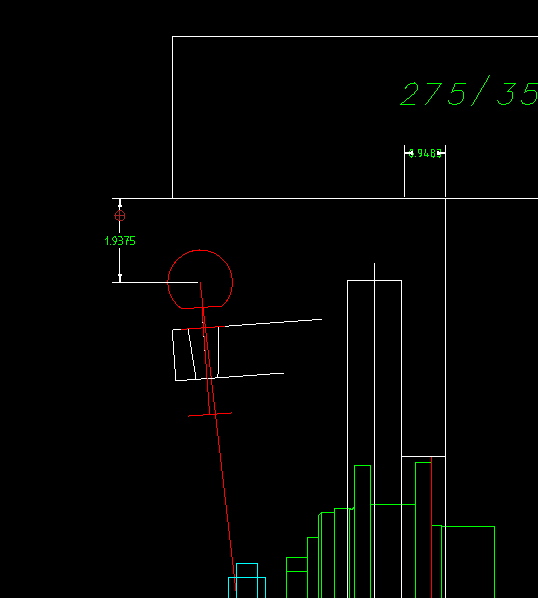

DionR. Why not just get your knuckle 3D printed as a test piece?
Have you thought about designing your knuckle to be 2" taller than stock from the centerline of the hub/spindle and drop the lower ball joint mounting location 1.5" to 2" from the centerline of the hub/spindle? Droping the ball joint mounting location would be the same as what Chris Birdson is doing with the lower ball joint drop brackets he is running on his B-bodies with a longer upper ball joint. I'm not entirely sure where he's ended up for upper ball joint length.

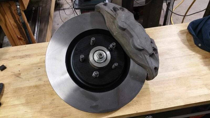

The S550 6 pistons Brembos can fit with a 14" S197 GT500 rotor in an 18" wheel with the right brackets. ;)
The S550 4 piston calipers will work if you machine/grind the outside of the calipers for wheel barrel clearnance.
I need to get back on finishing the bracket design. It currently works with drum brake spindles but I would like to come up with a solution for the disc brake spindles.
I actually printed my first design. Not ready to print another one yet. :)
I looked at raising the hub an inch (1" drop) but the outer tie rod end looked to become a limiting factor on wheel depth. Part of the reason to go to an 18" wheel is so you can run a 9" or 10" rim and a decent offset to get the tire under the fender. 17" wheels run into that problem and are limited in offset to like +30mm on an 8" wheel, and dropping the ride height 1" would put the OTR in about the same spot and create the same limitation.
And I don't think a 19" wheel work on an A-Body as the front tire is about maxed out at 26" OD. That would make the sidewall shorter than I am interested in running.
I haven't put much thought into making the spindle taller, but not out of the question.
Also, my understanding is that an A-Body has pretty good geometry with the LCA horizontal and any slope down to the wheel make it worse. And with the LCA horizontal, the car is pretty low. So a 1" drop spindle would end up with the LCA sloping down at the same ride height and wouldn't be the best idea, in my opinion.
I could get behind a 14" rotor and 6 piston caliper. Have to keep that in mind.
I haven't heard good things about the 4 piston S550 setup. Vorshlag has nothing good to say about them, partly because of the way the venting is on the rotors but I didn't get the impression he liked the calipers either.

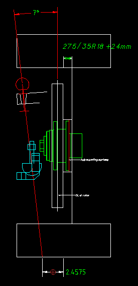

Have you thought about designing your knuckle to be 2" taller than stock from the centerline of the hub/spindle...
With an 18" wheel with any decent offset and width, I don't believe a 2" taller knuckle would fit. @BergmanAutoCraft has said he is running 1" taller balljoints so that would work, but I would bet that is the limit.
Note that the "inside" of the wheel above is just a line at 9" from the centerline. The wheel is going to take a chunk out of that distance.
When I suggested making your knuckle taller, I had forgotten how much room there isn't between the UBJ and the barrel of the wheel.
