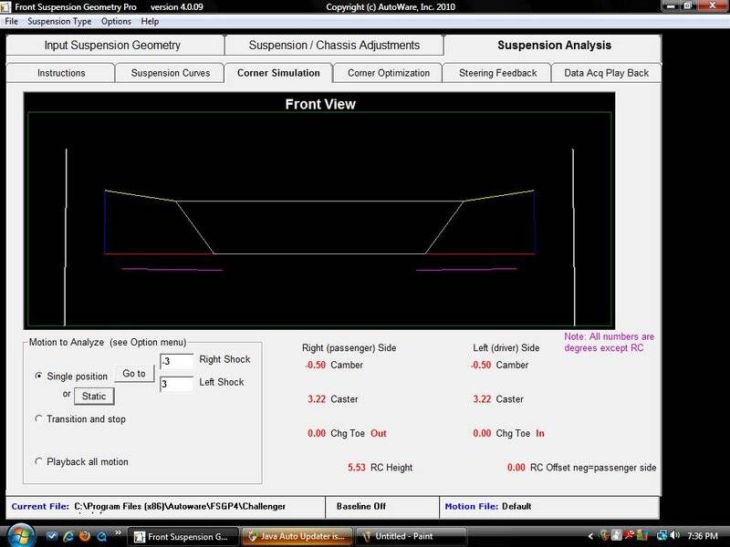

So were to begin....maybe with this: I have put my mopar's suspensions into an analyzer. I used Front Suspension Geometry Analyzer from Autoware. I plotted out iterations of a stock set-up, drop spindle set up, and the specific set-up used in my E body. I've plotted static positions as well as cornering positions to evaluate movement of the various intersection points and geometry changes. I'll stick a couple of screen shots of these in here of a static overall position and the bump analysis. If you look at the list of potential analysis points in the bump shot, you can see there are numerous ways to look at what is happening there.
Now, before someone asks me to post of new analysis and find any additional information, I'll offer this...these are screen grabs I took in 2010 for another forum I was participating on at that time. The program I was using was on a DOS based operating system. I have upgraded from that several times over and no longer have the ability to run this program and have never bothered to purchase a new version of the program compatible with my new computers. So unless I reconnect and reboot that old system, I can't contribute any new detail. But it can be done if someone wants to do it.
Next up, there always seems to be someone new entering the after-market suspension game. I always am encouraged to see that. Unfortunately not all of them will stick around. XV came on to the scene going gangbusters, but also went bust seemingly as fast. Although I think you can still get their parts from an engineering group that bought them out and is limping it along still.

A 1" lower ride height does not put the control arms parallel to the ground, they will still slope down from the pivots to the ball joints. Because of how the FSM measures the ride height its easy to know this, the factory spec puts the ball joint 1-7/8" lower than the pivot. So, you have to lower the car ~2" from factory to make the control arms slope the other way.
So yes, you will get better geometry out of the factory suspension than what is published in that article just by lowering the car ~2" from factory. Peter Bergman runs lowered with a 1/2" taller ball joint, I'd be willing to bet those numbers are better again.

There are lots of programs out there, some are super expensive. I have one that's actual Excel based, it's just taking suspension points and doing math. I haven't messed with it much but I need to plot out all the points on my Duster and run it through.

And based on what I see, I bet they actually did run it through a suspension analyzer. No idea if they would post it, but they have used too much technology in the design to not have done it.

To be clear, I only tossed it out there as an example of avoiding some of the compromises. By building their own frame rails, they can design them to support the weight of the car and set their own suspension mounting points so geometry can be optimized. At the same time, they compromised on the frame rails so the wide tires fit and they still have a bunch of steering angle at the expense of a narrow engine bay. I suspect that is why they offer custom headers (for $1700).
