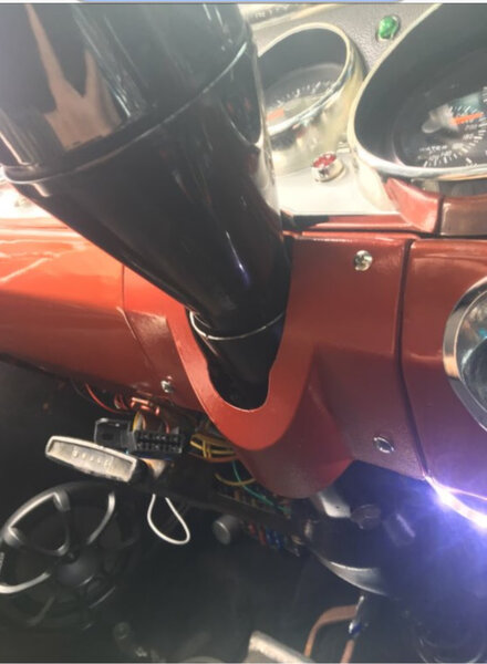

I used a flaming river tilt column. If you take apart your original column the flaming river will slide inside the housing and you will be able to use the climb support and the floor support without spending all the extra cash. I will see if I have photos. I posted them before how I did it. Save a tone of money and kept all original mounts.
