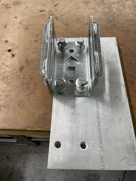

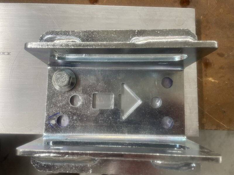

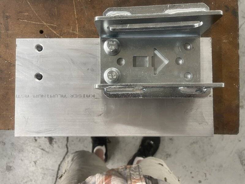

I just started fabricating my own slider mounting plates rather then welding them to the frame. One side is drilled and taped. I have 4 1/2” of movement forward and back at 1 1/2” increments. Still need to drill and tape the other side of the plate.
Strong work but I don't get it. How does it attach to the vehicle.

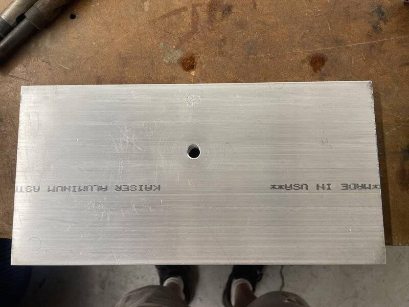

I cut the mounting plates in half to give me the left and the right sides. I was able to cut them with a table saw and a fine metal cutting blade.
I’m going to mill a 1/4 slot on the top side of the mounting plates and the weld them on the outer edge to the plates. Then bolt them into place through the bracket and the frame. I will do that when I mock up the rear end with the suspension so I know where to locate the mounting point for a forward and back adjustment.
Nice execution, but not clear why you need so much adjustability, and what the finished assembly weighs relative to the OEM hanger.
Rather than welding them to the frame rails and then have the slider max out based on position I can move it forward and back a few inches.
