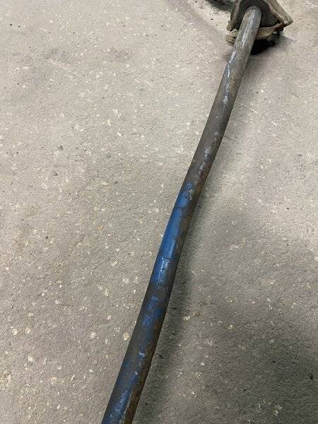

In the process of rebuilding the front suspension on my ‘67 Dart. It has the hd suspension with factory sway bar. It appears to be painted blue. It doesn’t appear to be painted over or a replacement, as it looks like original bushings, etc. I was wondering if they were originally blue like this, and if so, what color should I use for it? This being my first restoration of a Mopar, I’m not that familiar with this. Any input would be appreciated!

Yours seems to have been deliberately painted as the supports have no paint on them. The supports are welded on so not something that can easily be installed after the bar was painted.
Mine shows no signs of body color paint, might have black paint on it but 56 years of dirt, grime and road debris sandblasting it's hard to tell.
I would note that if the unpainted areas that are not blue are not surface rusted they probably had some form of coating on them
No, people...
The sway bar was left natural finish. ANY paint on any sway bar was not a factory effort.
The bar can be restored to the factory appearance with a sandblaster. A wire wheel will make it clean but too shiny,

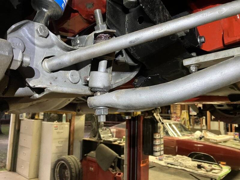

In Summer 2022, I had my engine and trans out. I sandblasted an aftermarket front bar since I wanted a sort of factory appearance.
To keep the finish looking nice, I coated the bar with this stuff:
First, the part gets sandblasted. You could wire wheel it then brush it down with red Scotch Brite pads to dull out the finish.
Next, the part gets wiped down with some type of acetone or other chemical cleaner.
This "RPM" stuff is a paste that needs to warm up a bit to spread and soak in. I left the parts in the sun to warm up, then brushed this stuff in. Over a year later and the parts still look "new".

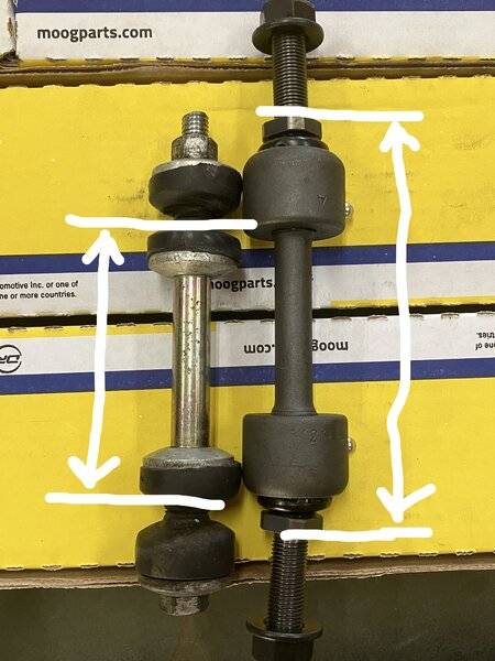

The end link is a MOOG. I shortened them to fit the 1970 B body.
I then welded them back together, sandblasted them to look Undisturbed, then coated them with that RPM stuff.
Those links have ball joint type ends. Better articulation and less slop.
I bought 4 of these.
Here you can see the difference in length.
After cutting, welding and sandblasting.

in 2003 after my Charger was painted, I rebuilt the front end. I had no sandblaster so I cleaned the parts and painted everything. The spindles, calipers, strut rods, steering linkage and steering box and sway bar got painted a dark gray metallic. The UCAs. LCAs, K member and torsion bars got low gloss black.
In 2022, I blasted the steering linkage, spindles, ball joints and sway bar and left them "natural" but coated with the RPM.
I'm not factory correct but have found that I don't get chipped paint since those parts are not painted.

Moog replacement for 1972 & earlier A-Bodies below the Moog K750074
Moog K8266 replacement for 1972 and earlier A-Bodies.
New ball joint style for Ford applications. As you can see, the "business length" is a bit more than a half inch longer. It's close to a bolt-in. If the extra half inch causes interference, it can always be shortened like @Kern Dog did in post #11.

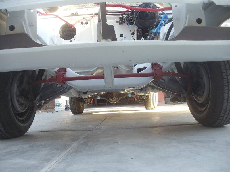

I imagine factory sway bars were not painted (or if so, black). I had some left over John Deere green I used the first time. The second time I stepped things up to red (matching the Commando 273 engine paint now). I wanted to "feature" the sway bar, more so than hide it.
