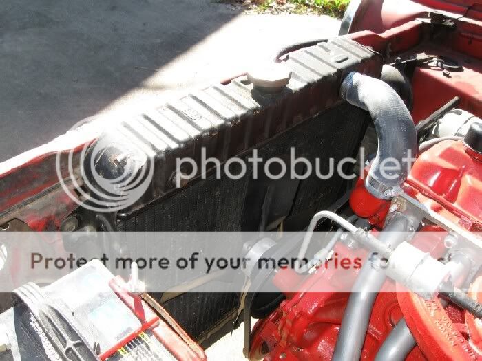

Here's what I have:
From your photo, it appears you have an early to mid 70's radiator (square top with a plug for some kind of sensor). You'll need a shroud more or less matching what you have raqdiator-wise and should be easier to find than the early A Body shroud that's in cosgig's picture. I see a little mounting hole for the left upper corner of a shroud just above the battery.
Good eye there dartman, the metal shroud will not work with that radiator. If you post the part number I can tell you what that radiator came out of and that would help a lot with your search. That poor little 4 blade fan has got to go, and pronto!!! Geof

Geof, one of the first things I found on this site is a big list of radiator numbers and descriptions. Checked mine, but all I saw is a three digit number on the top. Where are the numbers on these?

As for the radiator, the numbers are on the top, but that may not be a Mopar radiator. It should have a 7 digit part number embossed on the top, and a Pentastar if it's a Mopar radiator. Shoot a picture of the top of the radiator and post it here. Geof
Well, it looks like this may not be a Mopar, since the only number on the top is 527.
I sure would like to know what it is, so I could get a shroud for it. Any ideas?
I'm kind of concerned that I may not find one that fits, since the fan is offset from the center.
If I can't find one, what would yall recommend? As I said originally, cooling is only a problem under stop-and-go traffic on hot days. But there's obviously room for improvement.
